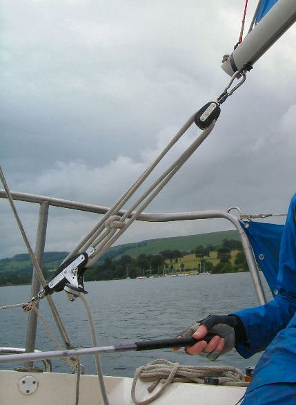

Hi All
This topic has been discused before on the old Yahoo group. This is what I wrote in June 2006:-
I've fitted a rope bridle with a small block running on it between
the two backstay anchorage points on the transom. When sailing with
more than 2 on board the mainsheet is rigged to this & a slider at
the end of the boom, to make more room in the cockpit, otherwise I
use the standard cockpit floor takeoff position.
This is the best picture I could find.
Rob

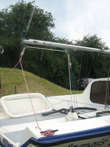

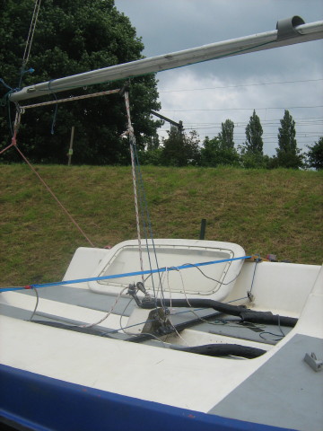

My boat is not a Swift, but similar size, same problem.
Even with a flat cockpit, with less problems, the mainsheet traveller was bringing as many problems than solutions, especially as there are straps across the traveller's track.
Now the sheet cleat is still in front of the cockpit, but the sheet is then led aft to the boom end, then on a block on the rope bridle as on Rob's boat, except that I'm using the runners anchorage points as the backstay fittings are close to the centreline on both sides of the rudder. Anyway there are neither runners nor backstay any more...
On a similar Micro, the sheet has a 3:1 purchase, I used 2:1, then the sheet is led back to the front of the cockpit, and another block on this end allows a further 2:1 purchase for fine trim, using most of the original traveller controls. Just a problem of management, there are three modes, light weather with fine trim totally released (gives 3:1 purchase), medium with fine trim set but not used (4:1) and finally fine trim used (8:1). effective purchases, related to the boom end, are 2.6 / 3.2 / 6.4, anyway better than the original 5:1 at 60% boom length, effective 3:1 !
Pictures are from a provisional installation, now the bridle controls are also led forward of the helsman position, further arrangement for the winter works is to have these controls available for both sides of the bridle to port and starboard helmsman position.
Phil
