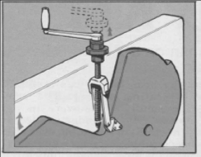

Yes you are on the right lines, beach the boat, obviously bow 1st remove covers to centreplate housing to take any upward pressure off the rest of the winding gear, if you are lucky it has just unscrewed off the thread. If you can get a rope or even better a strop under the lifted keel. As you are in non tidal waters you will have to recover the boat onto the trailer or get it lifted in order to remove the centre plate inspection cover to reassemble, the round cover is below water level with any additional weight on board i.e. you crew etc
Not a totally major problem , if the split pin has failed on the end of the screw easy job
If the bush has failed. I’m sure someone else on this site can help you out with a replacement

Thanks
Post by Kevinbwilko »
Thanks for that, will try tomorrow. The diagram looks somewhat different to what I have seen through the top..... but here goes!!!!!
