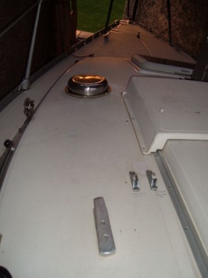

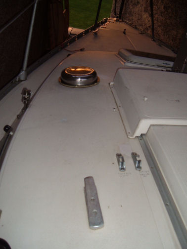

That said I led my control lines back in a similar way last season. I did'nt bring the reefing lines back but am in the process of doing that now. I,ve attached some photo's of Vega as she is now with no ropes on. I've got new organisers to fit, but space is restricted by the vents on Vega. As you will know Clutches are expensive so I'mtrying to see what else I can use. I used clamcleats for the spinny up/downhaul, spinny halyard & boom topping lift last year & these were ok but for the Main Halyard I aquired the Spinlock PXB cleat (closest to the hatch on the starboard side in the pictures) I may have to get a couple of clutches for the Reefing lines. All the fittings were screwed to the deck last season but with the extra load from the reefing lines this season I think bolts will be required.

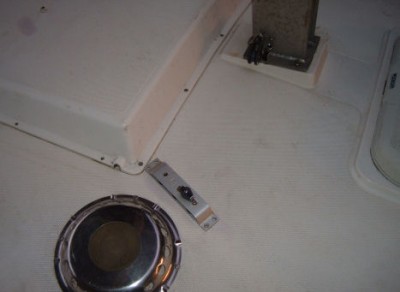

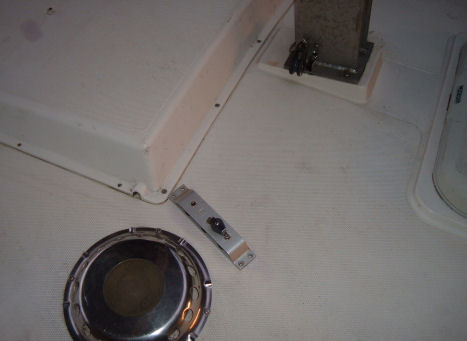

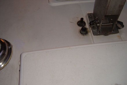

What I can't quite see from your photos is how you have attached the turning blocks to the bottom of the mast. It looks like you have used the bolt through the vang fitting.

Yes I forgot to mention how the blocks were fixed to the mast step. The large block for the main halyard is as you noticed fixed with the vang fitting bolt. The other smaller blocks are attached with eyes bolted through the mast step side. The two blocks for the reefing lines will be attached to the vang shackle.
I can reach the reefing lines from the hatchway at present but find it difficult to pull forwards along the boom (away from myself). I sail singlehanded a lot so need to make things as easy as possible, & leave the helm for as short a time as possible.
