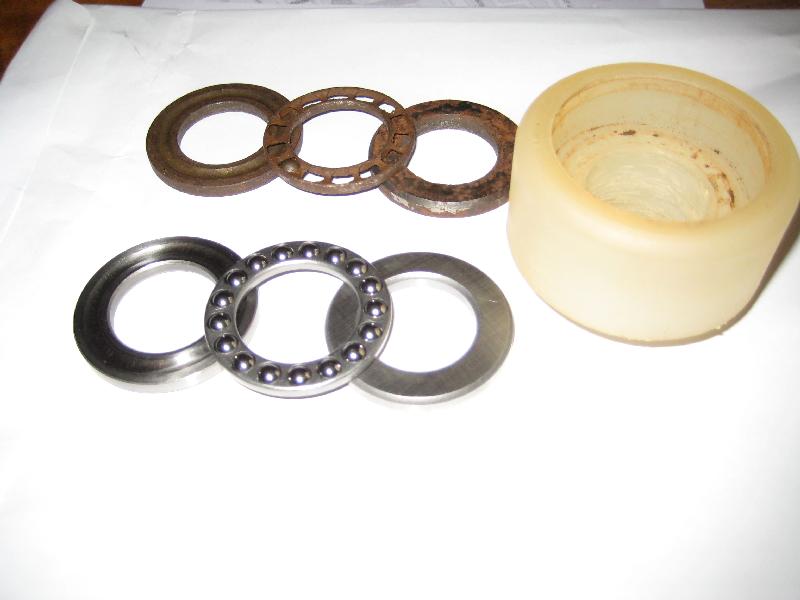

Hello everyone,
I'm a new member of the forum and about to buy a Swift. I must confess I've been lurking around for a while reading up about Swifts and the forum and website have proved fantastic resources and a major influence on my decision to buy this 20 year old boat. I certainly feel more confident knowing that there is so much knowledge and documentation readily available, and that the boat has such a strong Association.
I'll reveal the identity of the boat when the sale is completed... In the meantime there is a small repair that the present owner and I need to sort out which I hope you can help me with.
The boat is a 1987 300 series and it has been dry stored for the past 4 years. It has a new winding mechanism installed approximately 5 years ago. On a recent trial launch the keel would not go down - the mechanism was stiff after 20 turns. After much cleaning, lubrication and working of the mechanism it will now do the requisite 40-odd turns. However in this process we managed to lose down the box the ball bearings from the race under the stainless steel winding socket. This prompts us to replace the rather rusty race, but are not sure what to order and where from.
I found this useful message below, which certainly sounds like what we need, but I'm not sure if it's exactly right. Can anyone confirm what we need? It would also be very helpful if someone could suggest a supplier?
The race we have has an inside diameter of 1.25" and the outside diameter appeared to be ~1.75". There are (were) 14 balls in the race about 5mm (no micrometer!).
With thanks and best wishes,
Martin Lea

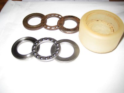

keel winding thrust bearing
Thanks for the pointer Terry. I've replaced the rusty dry old bearing with a shiny well-greased unit and the keel now winds smoothly and easily up and down.
From what I can gather, early Swifts had no bearing on the winder and the Torrington needle thrust bearing described in the Technical section sits on top of the plastic bush. Later Swifts appear to have been supplied with a ball thrust bearing recessed into the bush. (This seems to have happened as a direct result of a suggestion by Tony Adams in NL11), and it's this that I replaced (see attached picture). It's an
LT1-1/8 Imperial Thrust Ball Bearing 1.125x1.906x0.625 inch
A very helpful man called Steve who runs simplybearings.co.uk from a container in his back garden (coincidentally not half a mile from where Aperitif is currently lounging) supplied it from stock for £7.
http://simplybearings.co.uk/shop/p42267 ... _info.html
They can also supply the Torrington needle thrust bearing from stock.
