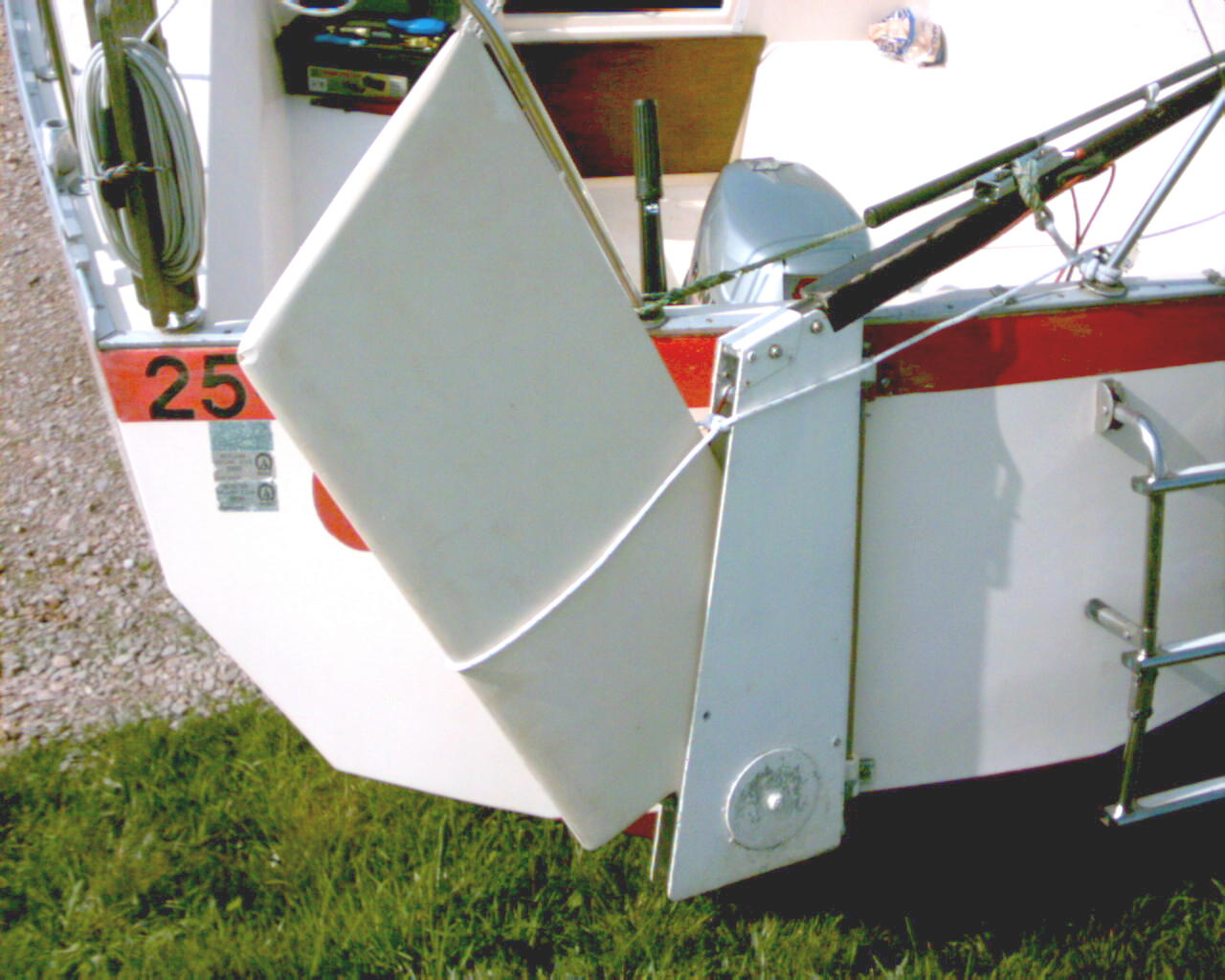

Hi Joe, Pleased you managed to get out of that one without to many problems! I also felt that our rudder needed beefing up a little on the stock so we added to large stainless steel plates on the outside. I have placed a picture here. Mike from sunny Norfolk may be able to assist you with a new rudder?? All the best Gary & Ruth

I added some pics of the broken rudder in the gallery section under joe_swift18. I hadn't realised when I wrote the first mail on this that the stock was also damaged when the rudder broke away. There seems to have been a piece welded onto the bottom of the stock to give more support to the rudder and this sheared off on one side.
I've bolted the rudder onto the stock with 3 bolts for the time being but haven't tried it out yet. Unfortunately, I didn't realise it would end up with a rake back when following the line of the stock so it'll be a little heavier to steer than it should be.
